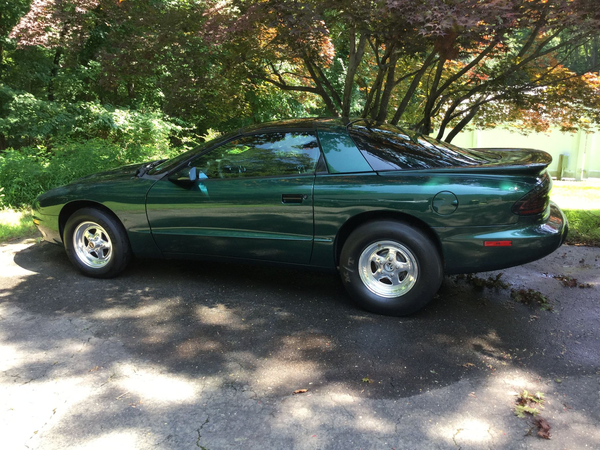

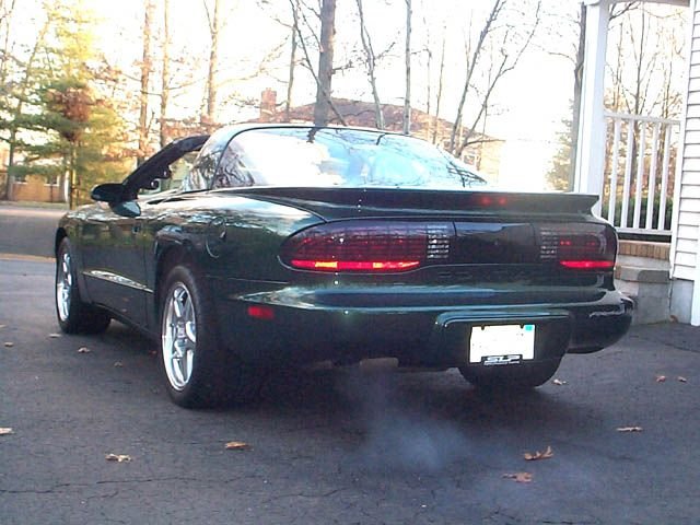

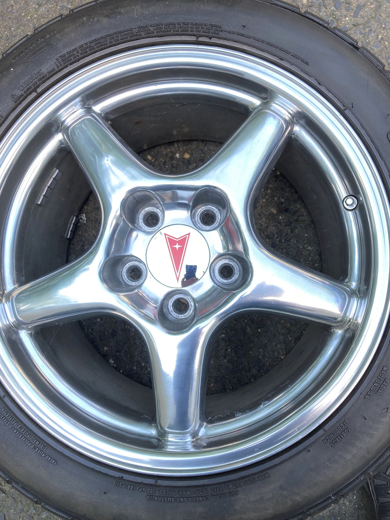

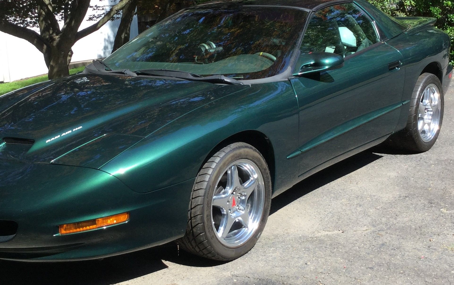

There are 17 x 9.5" 56mm w/ 275/40-17 in the front, and 17 x 11.0" 50mm, w/ 315/35-17 in the back, If you went with the 17 x 9.5" all the way around, the outer edge of the tire would be about 1" deeper in the fender well in the back, compared to the 11.0" wide wheels.

The wheels originally came with plastic Corvette emblems glued on the center caps. Brent Franker made the silver disc decals with the Pontiac arrowhead for me.
BTC Sep 24, 2021 05:10 PM
Re: Abysmal tire options...
Those wheels look really good on your car, Injuneer. I've gotta get some new wheels and tires. I don't get to drive my car very much, but I'm still running the stock salad shooters on my '94 Z-28 and the tires, which are in surprisingly good shape, are at least 21+ years old. Wheels are quite the difficult decision.
