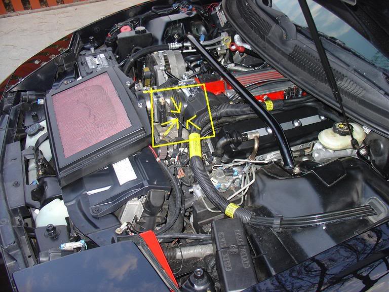

What does this hose go to?

Hey guys I'm going to put in a new air bellow and i was wondering what this goes to? Do I need it? Thanks!

Sorry that it's not zoomed in more. But I think the LT1 guys will know what i'm talking about. It's the hose that has the blue elbow on it.

I think its to the opti...

Yes, it's the vented opti hose.

Ok sweet, thanks! Another question? Do I need it? Can I put it some place else? Thanks again!

Yes, you need it. Ain't really anywhere else to relocate it to. That hose helps evacuate moisture from your opti. That's a good thing!

^^^^Amen to that! You can relocate it anywhere in the intake tract AFTER the MAF, doesn't leave much choices so I would just leave it where it is.
