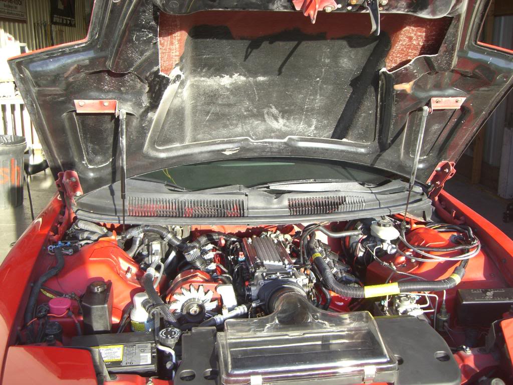

funina91ss May 8, 2009 12:38 AM
Opti delete
5 Attachment(s)
Just a few pics to hold you guys over.
Slide show of install pics!
Attachment 33714
Attachment 33714
Attachment 33716
Attachment 33717
Attachment 33718
Will post more and a write up when I have time. Right now it's time for bed. I have to be up at 6:30am.

funina91ss May 9, 2009 09:09 PM
9 Attachment(s)
Well we decided to go one step further and install a LS1 air lid.
Attachment 33652
Attachment 33653
Attachment 33654
Attachment 33655
Attachment 33656
Attachment 33657
Attachment 33658
Attachment 33659
Attachment 33660
