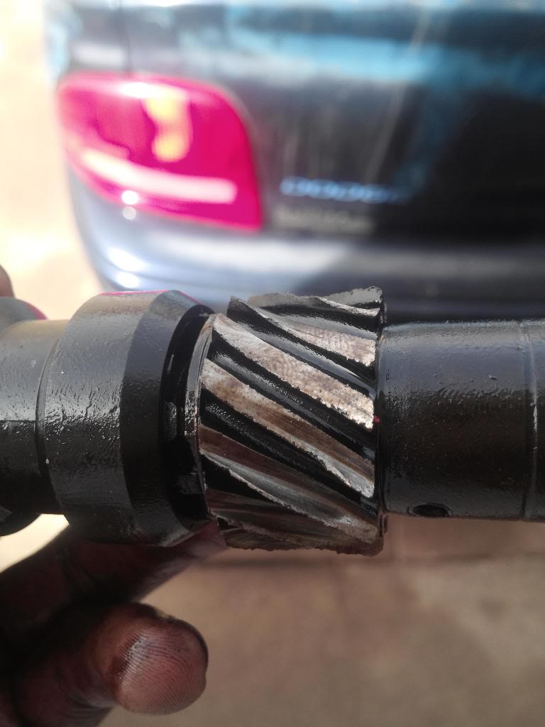

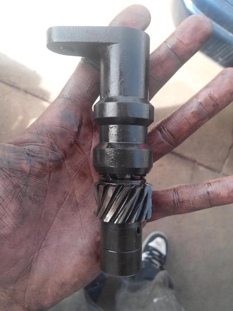

Size:  63.1 KBName:  CAM00029_zpsd7d9483e.jpg

If the teeth were sheared off and the shaft was not turning, there was no oil being delivered to any part of the engine, not just the top end. When you get the new shaft/gear, make sure the oil pump turns freely. It may have jammed and caused the teeth to shear.
Check the camshaft gear teeth for damage as well.

You can get a new drive assy from GM. Part #1103868. That one is toast. You can replace the lifters if you want, but they were probably only making noise because of the lack of oil. Injuneer was telling you to peek at the gear on the camshaft (you'll have to try to look into the hole at the back where the drive came out). Chances are it is ok. There is not much else to address in the lifter valley. You can try to turn the pump with a screwdriver or priming tool (through the hole) to see if the pump is moving ok.

What was the condition of the plastic retainer? If that was broken, it could allow vertical movement of the shaft, causing incorrect meshing of the drive stub gear to the camshaft gear. If the cam has ever been replaced, there might be a mismatch with the metallurgy. The oil pump may be difficult to turn, increasing stress on the gear teeth. A high volume oil pump would increase the load on the drive system.

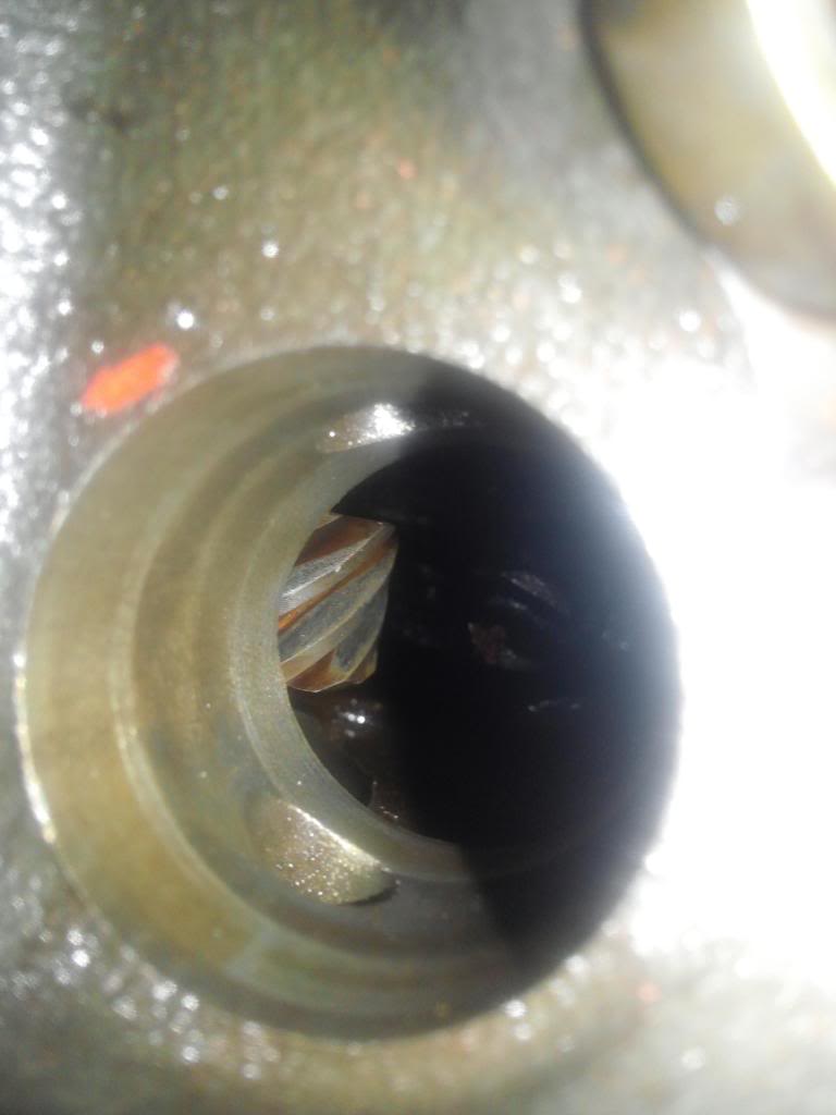

Size:  41.6 KBAlright. Part will be in tomorrow and i finally ordered it. But id like you guys to view the picture and take a look at this cam bearing and. Is she still fine or....? Also the thing is when the oil pressure dropped to 0 the car was driven for about 30 - 35 miles but not continous. On and off to a rough estimate all together. As she was brought home, there was no knocking, no abnormal driving, no SES (Besides Check Gauges), or overheating besides the lifters taping. So given that.... how long do you believe the engine will last after reinstalling the new shaft and a tune up? I plan to replace the engine anyway within a year or so.

The metal from the stub shaft gear has to be in there somewhere. The cam gear (not a bearing) looks OK. Bump the engine to observe the rest of the teeth.
Cut the oil filter open and see what's in it.
