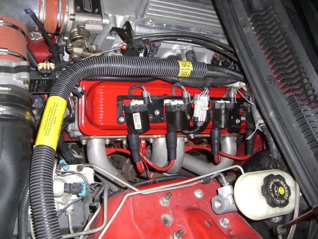

5 Attachment(s)
I got the car together now. I ended up just going ahead and pulling off the old plug wires and running the new setup since I had to pull the alt and p.s. pump to get the old wires out of the way. I also had to replace a header gasket on the rt side. The car seems to run just fine on the 5.3 truck coils. It will be a few weeks before I can get it to the dyno. I still need to get some parts for my nitrous kit and I am leaving for vacation in a week. I will let you guys know what it does.
Attachment 45969
Attachment 45970
Attachment 45971
Attachment 45972
Attachment 45973
Projectcam94 Aug 10, 2008 11:09 PM
That looks nice
JoeliusZ28 Aug 10, 2008 11:45 PM
Awesome job on that! you have a PM
funina91ss Aug 11, 2008 08:27 PM
Thanks guys. I am having some starting issues with the battery being in the back. After the car warms up I have to let it sit atleast 10 min before it will start back up. I can put a jumper box on the Power distubution point and it fires right up when hot. I have 2 gauge wire running from the battery. I might need to get 0 gauge wire.
