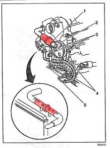

Does your car have the power steering cooler on the engine? It would be a can-shaped device, just below the throttle body, with 4 hoses, connected in the line from the radiator right side to the water pump. Theoretically I suppose, hot power steering fluid could overheat the system.
