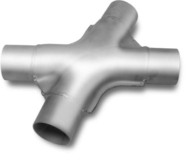

Re: I've got a few exhaust questions...
yeah, but the angles that the inlet/outlet of the X are not all that easy to fab up to a Ypipe
the better bet is to get the magnaflow X ...which has 3" inlets that are parallel. that way you can just run the proper bend off the Y pipe...side by side...and into the crossover...then out side by side
like this
as opposed to this
sorry the links won't work for long...
like this
as opposed to this

How do they work and how will I use it?
- Do they crossflow or do they form an X and just V Bend at the center?
- Where exactly will I use it? Will I have Pipe fabbed from the cats to the Exhaust Tunnel and place the X-Pipe right before the exhaust tunnel?
