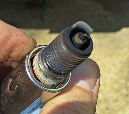

Pulled 5 of the 6 plugs after revving till it dies and they are not wet with fuel and no sign of anti freeze
