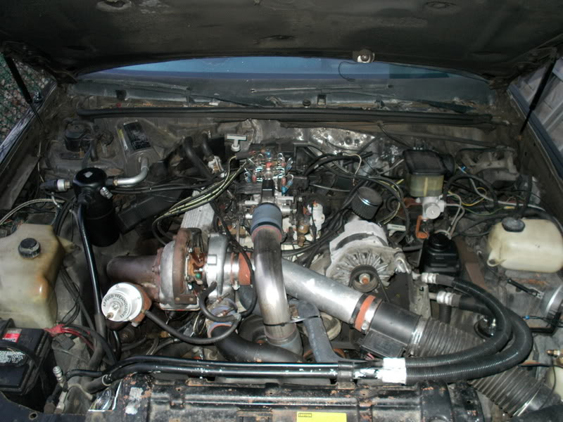

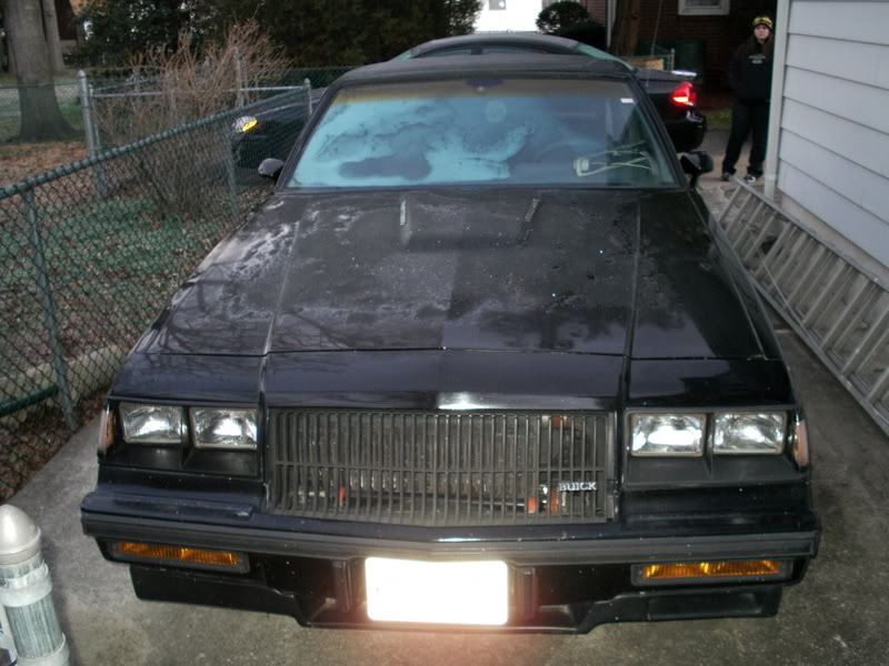

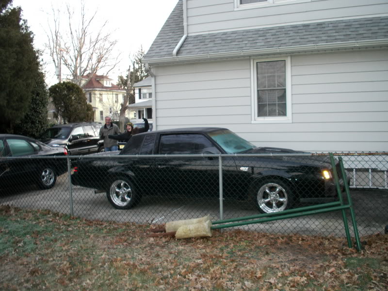

The GN is running on 5 cylinders due to a injector that crapped out. I ordered a new one and had it sent home to give my dad something to do when he's bored. Right now he's been spending time fixing up a boat that he purchased. The powermaster brake unit isn't working and I'm not there to diagnose it, new units sell for like $650 from ebay. The roof has a small rust hole, and both doors are rotted out on the bottom. So it needs to visit a body shop with a large check. Other than that it's good to go but I move once and a while with my job with little to no notice. I picked it up a few years ago for $5,500 so I couldn't pass it up. It has a built motor, tranny, rear, direct port nitrous, precision turbo, FMIC, IC sprayer, line locks, alcohol injection, max effort 12 way chip, and a butt load of gauges.
