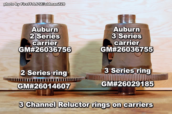

There is a series 2 carrier and a series 3 carrier (doing this from memory at work but recall that 3.08 and taller gears are series 2; 3.23 and shorter are series 3). If your axle is stock, think you should have the 3.42 ratio (RPO GU6) in a manual trans car which would be a series 3 carrier, and would work with a 3.90 gear set. Also there are "thick" gear sets which let you run shorter ratios on the series 2 carrier.

A 1994 should have non-traction control 3 channel abs (there is wired sensor on the top of the center section) and there is a fairly fragile reluctor ring on the carrier next to the ring gear that sends the speed signal to the abs. That part is no longer available anywhere in the known universe, so busting a tooth off would be bad; the pickup is still available but is about $150 bucks.

I haven't seen a 3.90 (thick) set for 2 series anywhere.
The ABS reluctor ring does not have to be touched/removed for a gear change,it's pressed onto the carrier,not the gears.

Also did not intend to imply the reluctor had to come off the carrier, only that when you have the carrier out, be careful as the reluctor ring is the most fragile piece in the rear end and there is no source for a replacement. GM actually uses a special tool that is a reluctor ring protector when the carrier is out.
