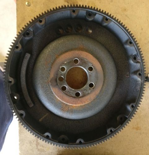

1 Attachment(s)
getting a stock replacement FW and clutch kit should be plug and play. With that said...most of these FW's & clutch kits are offshore made and the PP on most clutch brands do not have any balance holes in some of the 3 PP surface tabs nor do they have the paint dab on PP that you would line up with, or as close to, the dowel on the crank.
Stock LT1 motors are externally/rear balanced. The stock FW should have a cast in weight on back side and typically a few large drill counter sink type holes somewhere on the back and or pins placed in the outer holes of the FW
If the crank no longer has the dowel you just line up the FW so that hole lines up where the dowel would go if it was missing.
you can either pull the starter or drop the dust cover off bellhousing and have someone rotate engine by hand to see if the cast in weight is there. I have never seen a replacement stock FW without one though
for the purpose of this pic I positioned the PP & FW to show balance holes on PP and pins used to "zero" balance a stock FW after the cast on weight was ground off for my INTERNAL (not stock) motor. The blue paint marks on both PP & FW would be positioned to line up on assembly. This is just an example of how a PP is balanced from the manufacturer....not something many China made PP have anymore.

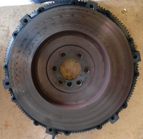

This is the current flywheel front (transmission) side showing.
https://cimg1.ibsrv.net/gimg/www.cam...f1756b5884.jpg

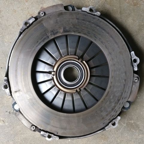

Flywheel side of the current pressure plate.
https://cimg3.ibsrv.net/gimg/www.cam...9d514bf989.jpg
Transmission side of the current pressure plate. From a previous post I'm following that the yellow mark, at 12 o'clock,should be aligned with the dowel pin as closely as possible.
https://cimg4.ibsrv.net/gimg/www.cam...50c0b32677.jpg
This is the backside of the old flywheel. I notice it has a metal pin, at 3 o'clock, in one of the outside holes that the replacement flywheel doesn't have.

Your clutch & FW pics look fine. The spring hub part of the disc goes towards FW. Sounds like you have installed everything right
The pin in the outer hole of the old FW was used in balancing. Some FW may have none
I have replaced several clutches and FW's without any balance issues on stock motors (internal balanced). Weird you are having issues on a stock motor but "maybe" the replacement FW is just off...although it does have the cast in weight and other drilled balance holes
