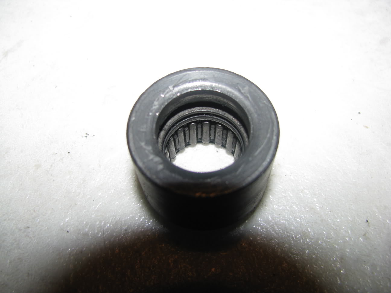

the pilot bearing doesn't seem to be fully intact...seems to have slipped out of its outer ring a bit, and just came right out of the crank with no effort at all. just stuck my finger in and the bearing came right out....good thing it came off my finger
could this have been part of my problem? I will for sure be going with a bushing now.
