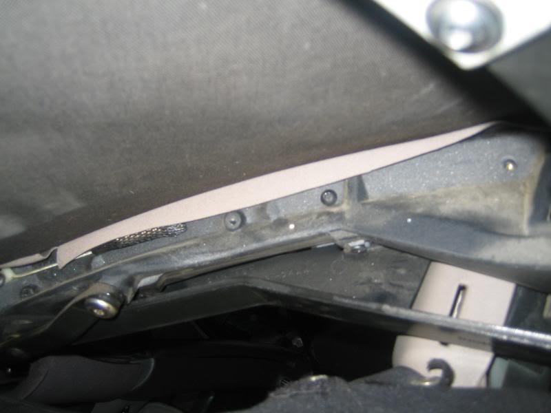

You should now be able to pull the weatherstripping right out of the metal trim piece it is pressed into.
Attachment 43403
You will need to remove the top 3 screws, the bottom screw only goes into the sail panel and can be removed as an assembly. Once the screws are removed pull the top back down. Working from inside the car, on the back of the area you just removed the screws from, locate and remove the 2 allen head screws that are holding the sail panel to the metal frame.
Attachment 43404
(sorry for the bad pic, but they're there)
Once all of the fasteners are removed, remove the sail panel/metal trim. This may require a good yank as there is some kind of gasket/sealer on the back of these parts.

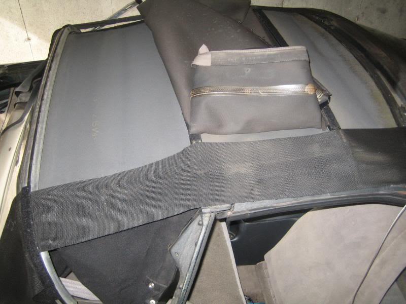

In the back pull this strip on the rear bow. Again try to leave any nylon in place, If it needs to be moved take note of where it was attached and replace as soon as possible.
http://i2.photobucket.com/albums/y10...p/IMG_1683.jpg
Fold forward.
Attachment 43390
The top is not stapled on the two center bows as I had expected it to be based on every other source of instructions I read. Instead the fabric strip is wrapped around the bow, glued, and is clipped in by a plastic strip that the headliner is attached to. The first thing you will need to do is separate the plastic strip from the bow. It's a tight fit so be careful that while you are prying away at it you don't slip and bust through the headliner.
Attachment 43391
You can now just peel the fabric strip off. Do this one more time and the main top is off.

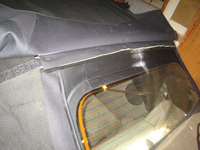

Take you new window panel and lay the old panel over it. Align the top plastic strips together. If the old and new panels are not the same width center the smaller one within the bigger one. (Mine was slightly smaller and the window itself is a little smaller and higher, I guess that is the difference between a $450 top off eBay, and a $1600 top from the dealer.)
Attachment 43352
Once you are good and lined up go ahead and get to cutting. This part can be a little scary since one mistake could be disastrous....no pressure. I did not cut out whole chunks as you see in the photo, instead I cut 'X's that went from the longest point within each existing hole on the old top.
Attachment 43353
Remember this: If you cut the holes too low you can always extend them up a little, If you cut them too high you might end up with a whole/cut that is showing above the car.
Now is a good time to take a little sandpaper to the hole you have in the rear bow from drilling out the rivet. You want to make sure this area is smooth, otherwise you risk wearing through the top.
Once your holes are cut slide the strip into the top bow and center it. I just made sure I had equal distance on each side between where the top ends and the notch the plastic slides into bevels back and ends.
